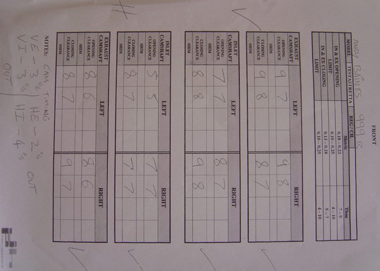

Heres the valve clearance and cam timing chart from my 999r.........
as the testastretta allready has vernier cam pulleys the timing was easily rectifiable
