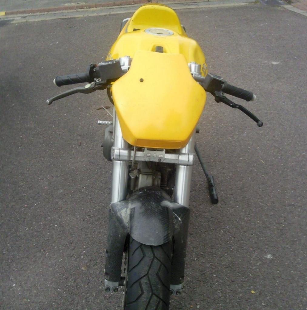

As well as getting out on my DD bike yesterday for the first time in a few months, I also got to try out My Class B bike after first giving it a £20 run on the Enforcement Dyno and then giving it its first ever track outing. Using rather old Diablos.
Wasn't quite sure what to expect as its so different from my DD race bike which is not only a 6-Speed 620 housed in a early SS chassis, it also has mods to the suspension and twin front calipers, neither of which the 583 has.
Still that initial test session wasn't to bad, first changes I need to make is reposition the gear change and also lift the bike up the forks a bit.
The lack of a fairing was interesting in that it felt odd not having anything in front of me so to speak. I didn't really need a Tacho to ride it on track but the Dyno guys could have done with it as Max Power was measured at 3750rpm, maybe they need to double that. Not only was the bike void of a Tacho but also their ignition pickup for the Dyno was broken.
The engine is completely untouched and although carbs have a dyno-jet kit fitted its running standard air-box lid and standard paper filter. Exhaust is standard down-pipes with Hi-level Sils.
Max BHP in 4th Gear Roll on was 44.9hp (SAE) with 76.7 lb/ft of torque, almost as much torque as the ZX10R that had just been on there.
May have to have a play with the cam timing at some point and see if I can move the power around, bumping up the horsepower and reducing the torque.
As always with these projects there’s a bit of development work needed, I’m still unsure of the single disc set-up although the OEM P4 Caliper worked well enough with the Aprilia RS125 front disc and the Monster S2R master-cylinder, but the conditions were hardly ideal for pushing any brake system to its maximum.
