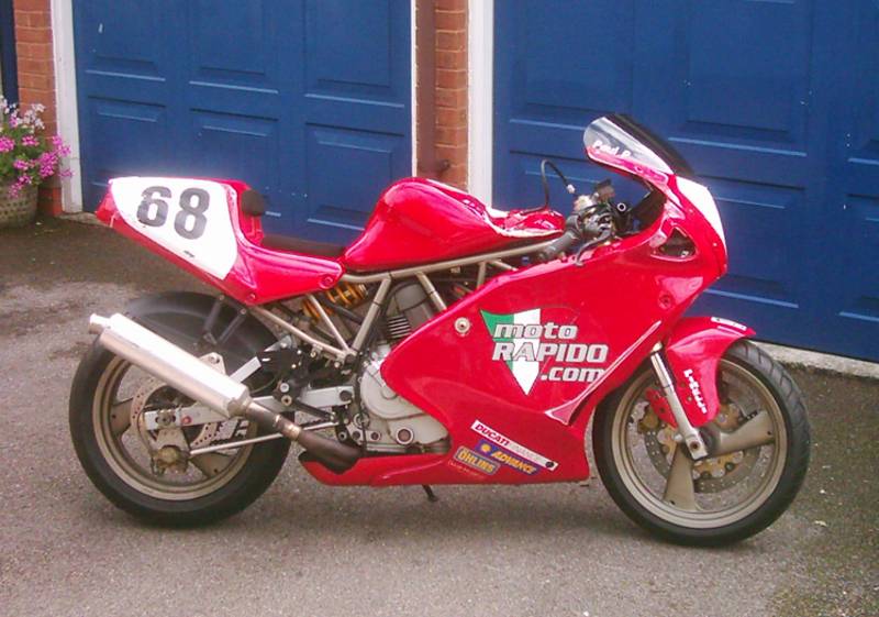

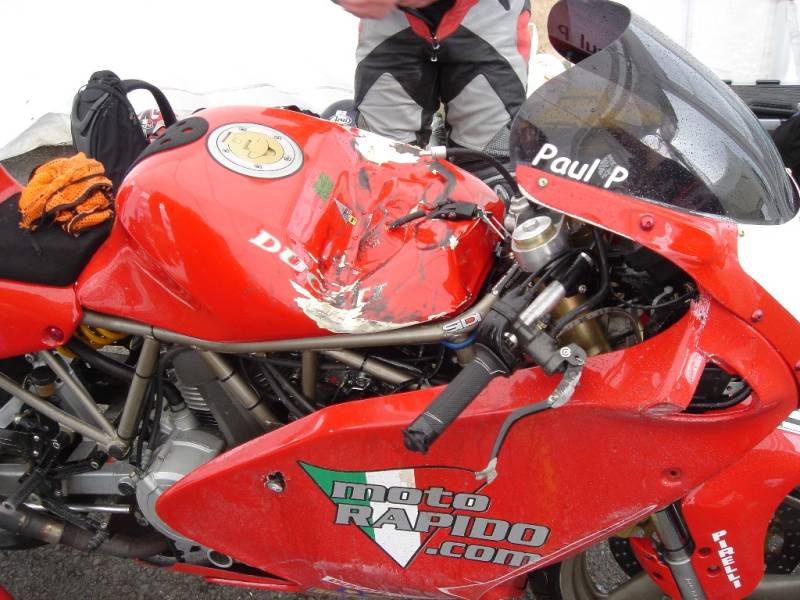

All you need is a little bit of water and you can reduce the volume of the tank while keeping the standard fittings:
(and yes it passed scrutineering for Race 2!)
Click image for larger version Name:	donny01.jpg Views:	167 Size:	81.6 KB ID:	12705  Click image for larger version Name:	Donny02.jpg Views:	158 Size:	68.6 KB ID:	12706
