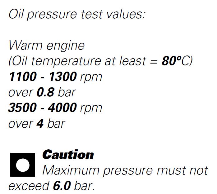

Taken from the workshop Manual
Click image for larger version Name:	Oil Pressure.jpg Views:	591 Size:	50.8 KB ID:	13416

As the return pipe from the cooler just returns the oil back to the sump with no restriction the pressure is at atmospheric i.e 14.7 psi. As RPM increases flow increases through the cooler.
Yes there may be a slight pressure increase due to the restrictive passages of the cooler but nothing like the pressure that the engine is running at.

I'm under the impression that the max pressure the cooler needs to be able to cope with is around 80psi, as its not particularly pressurised but merely a passage way back to a pressurised crank case ?

Worst case scenario is you have a blockage on the return resulting in the cooler getting exposed to the maximum pressure at high revs.

The pressure going in to the cooler will be much less than 80psi due to an open return back to the crankcase, and crankcase is not under pressure, if it was it would blow a seal, hence the breather at the rear.hope this helps
That does it for me, thank you.
