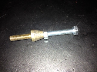

The ignition barrel is still on as I can't work out how the thing comes off.
There are two conical smooth bolts holding it on, they have a thread on the inside. Any ideas how I undo them?

I use an Easy out for removing the Ignition Switch bolts

Easiest way it to get a long bolt that is the same thread size as inside the cone (M6), and put a nut onto it. Wind the bolt (with nut) into the cone as far as you can then lock the bolt in place with the nut. Undo the bolt and it will bring the cone out with it!
Click image for larger version Name:	cone_bolt.JPG Views:	485 Size:	34.7 KB ID:	13506
I think I am dumb.
I tried this but it didn't work. I did manage to bend a couple of bolts though.
I did exactly as you said except when I undid the bolt the bolt + the nut simply come out.
What am I doing wrong?
