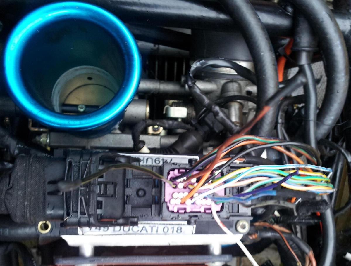

Phil the Drill returned Dallas's old bike back to me yesterday so I set about removing the Nemesis and replacing it with a reprogrammed 749 ECU.
No matter what I tried I just couldn't get it to turn over let alone start when connected to the 1098 dash, removing the CAN wires from the clock allowed it to turn over so on the 1098 it looks like the Dash immobilises the ECU Via the CAN line as well as the Key_Lock
So I reconfigured the dash connector and fitted a 749 Dash, hey presto the bike turned over and tried to start, but just wouldn't catch with enough revs for the starter circuit to drop out. Tried various things and still not getting any futher, felt like it needed more fuel.

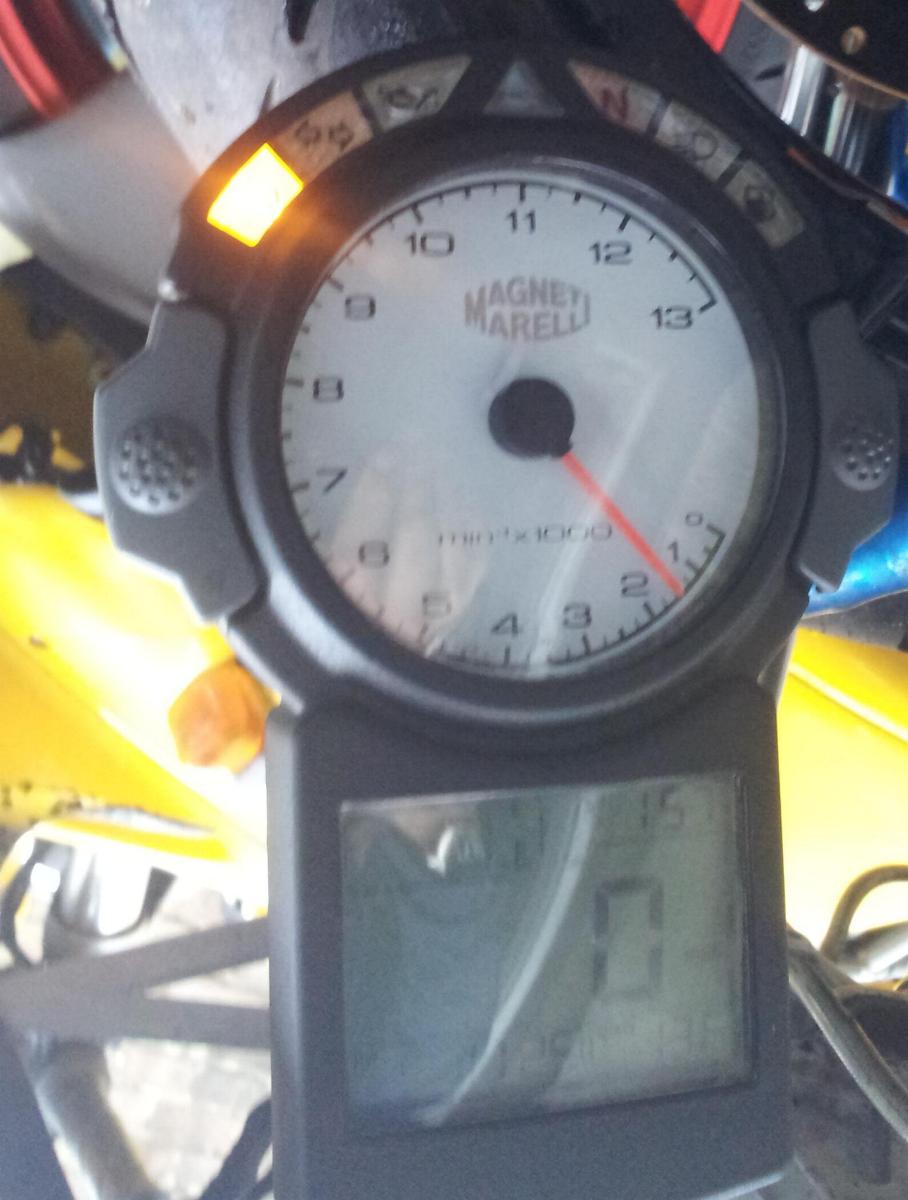

Here's one I did earlier, earlier today that is
Click image for larger version Name:	749 Dash.jpg Views:	718 Size:	91.1 KB ID:	13364  Click image for larger version Name:	ECU DSConnector.jpg Views:	747 Size:	132.5 KB ID:	13365

Love the 749 clocks, looks fantastic! What is the benefit of them and the new electrics?
Old 29-Dec-2012, 12:56   #6
Simon the main difference between what I have removed and what I have fitted is the cost, RRP on a Nemesis is about £800
