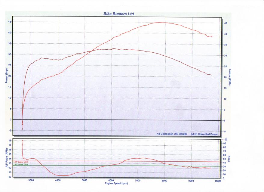

hello, just had my bike dyno'd 43bhp,,, is that good? I'm told that better ignition modules will make it more, does anyone know? apart from that its all good (i think) what do other people have, do you know?

43bhp is very low, the limit for class B is 53bhp
As for igniters, how will they improve things unless they alter the advance and if they alter it by a few to many degrees it would make them illegal
1.6.31 Ignition/Engine Control System
Ignition/engine control system (Ignitors) may be changed. Any alteration that allows the number of degrees of spark advance beyond the manufacturers standard specification is not allowed.
Have you had the cam timing checked, they can be along way out when they left the factory

IIRC 48-50 at the real wheel is par for the course on a Class B bike.
Dynos can vary a bit though and there are a lot of things that can affect the real wheel horsepower other than how good the engine is.
Was the dyno operator happy that is as good as the engine can manage. Did they give any feedback on the fuelling?
You'll find out for sure if you are down on HP on the long journery to the first corner.

Mine is running std ignitors at 52bhp, As Kev has said I would get the cam timing checked out, Mind it would have thought it would have to be a fair way out to lose circa 20% HP
What spec is the motor?? Airbox, Pipe,Jetting Etc
As has been said what is the fueling like on the dyno sheet, I think you need to scan and post it up here.

here's the dyno
I cant loose........ if I do well it's me not the bike and if i do bad.... it's that bloody bike!!
Sounds like most racers doesn't it?
Anyway here's the dyno...
Click image for larger version Name:	dyno dd b.JPG Views:	364 Size:	68.4 KB ID:	10348
