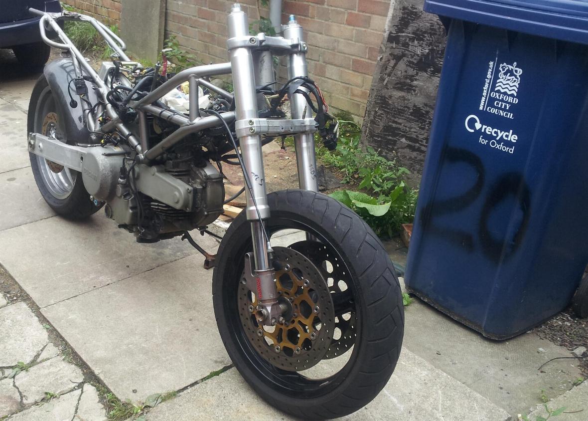

And the pile of bits collected in the back of the car have turned into something a tad more useful
Click image for larger version Name:	New Project.jpg Views:	1621 Size:	164.9 KB ID:	13707
what is it kev?
Old 20-Sep-2013, 18:26   #14
Originally Posted by mat2hew
what is it kev?
Monster 620

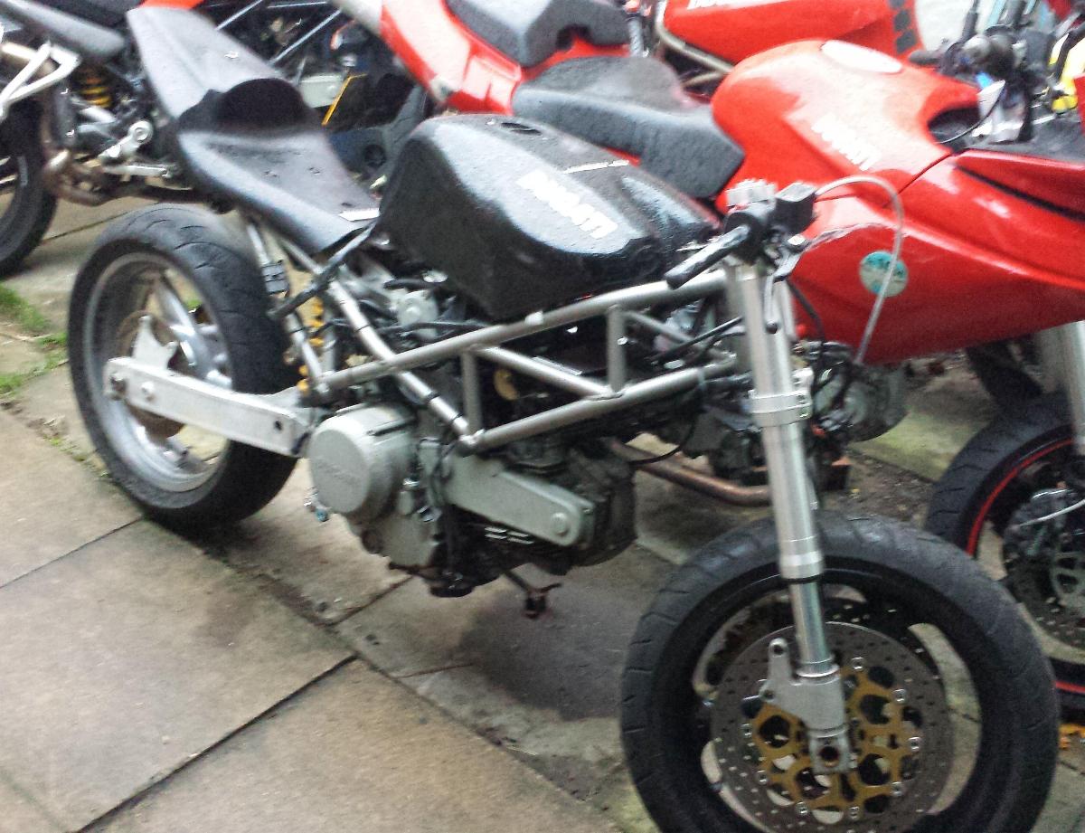

Been working on my own bikes over the last couple of days including the bike pictured above which is now almost complete and ready to run, as such it will be a good spare for next season
Which means I will soon have a unraced 620 Engine, Injectors, Decoded ECU and loom for sale
Got it running a few weeks ago and now thanks to Dallas it's looking more like my 2014 DD bike
Click image for larger version Name:	DD2014-Spare02.jpg Views:	1261 Size:	161.2 KB ID:	13732

Tank looks well nice.
Old 28-Oct-2013, 12:27   #18
Cheers Simon, will be very similar to my 2014 race bike.
Apart from acting as a spare it will hopefully be an experimental bike
I have several shocks I have modified to fit, including Ohlins, WP, Nitron and Penske
And will have a couple of fork options to try
One set similar to yours which will be using 916 internals
2nd set will have the Mupo cartridge kit in them that didn't work at all for Dallas in 2012
and then a set of ST3 forks with a FG piston/shim kit in them
Also want to try slightly different fork spring rates such as 0.85 / 0.875 / 0.90 kg/mm
