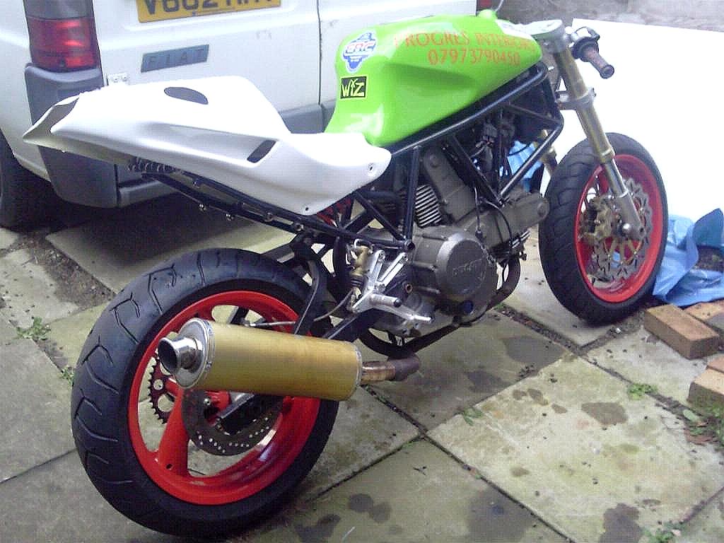

With the 620 now running and still having a few hours to spare today I decided to do a bit to the Class B bike and then take a few pics of which this is one.
Even had time to pop out on the S2R, missed Kev, Trudi, Dave & Brenda at H-cafe but caught up with Nev748 over there, good to see he's looking after my old 748
Click image for larger version Name:	Photo0034.jpg Views:	463 Size:	114.6 KB ID:	11321
