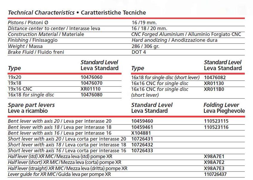

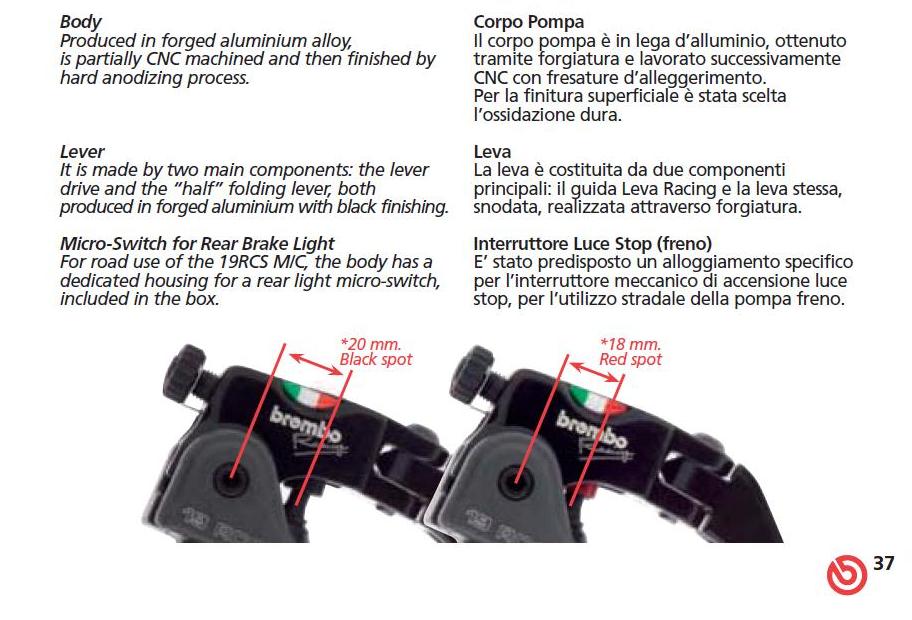

Old 05-Feb-2011, 10:44   #15
And again the point is missed, its not just the piston diameter but the combination of the piston diameter and the lever ratio that also plays apart.
Magura recommend the 195 radial m/cyl with a 16mm diameter for bikes with two 4-pot calipers
Brembo recommend their 16 X 18 and 16 X 16 m/cyls for bikes using one 4-pot caliper

Old 05-Feb-2011, 17:54   #16
but Magura dont mention the lever ratio (that I've seen) and I assumed (maybe incorrectly) that most 16s will be the same ratio

Old 05-Feb-2011, 20:03   #17
Adjusting the span is just that, making the span fit your hand, if its closer to the bar its easier for you to pull, but doesn't change the amount of fluid you move, that is the same amount of mm travelled by the lever moves the Piston by the same amount as before say you pulled the lever in by 20mm the piston will have moved 4mm no matter where the span is set.
Magura quote a lever ratio of 1 to 5 for the 195 range (the one you have)
and they quote 1 to 7.2 for their 190 range of Radial Mastercylinders.
Brembo figures refer to Piston Diameter and Pivot point position
