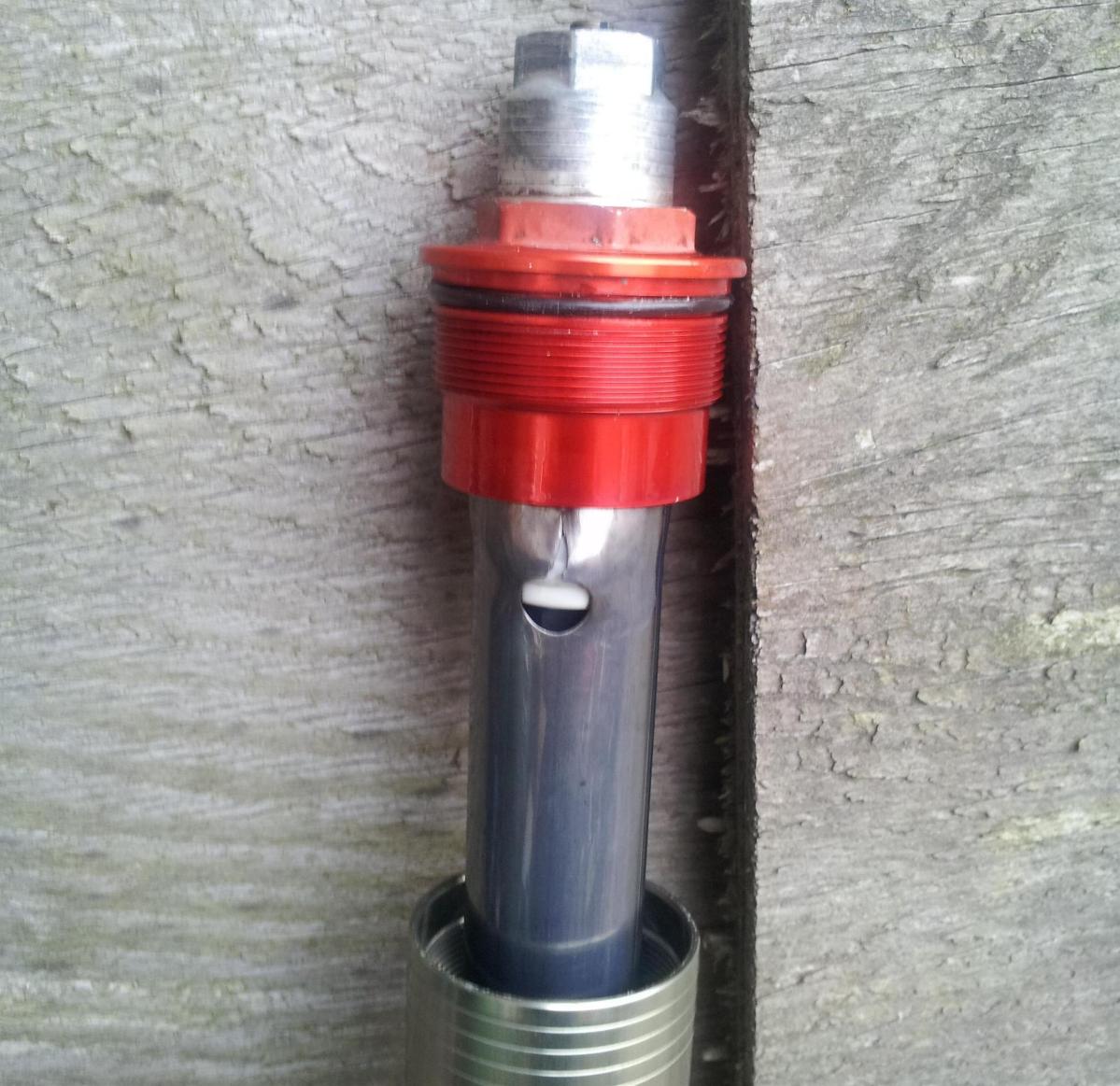

Old 01-Jul-2013, 16:30   #23
But also building up a set using 996 internals in 750SSie Dark Outers with 1000SS fork caps
Be nice if someone hadn't already botched the 996 internals
Click image for larger version Name:	996 Fork.jpg Views:	281 Size:	163.3 KB ID:	13612

The cap looks ok .... might make a nice paperweight
Old 04-Jul-2013, 00:04   #25
Caps no good for a DD bike as its to big
Forks are now all assembled, just need to add oil, set the appropriate air gap and see how the after market seals hold out

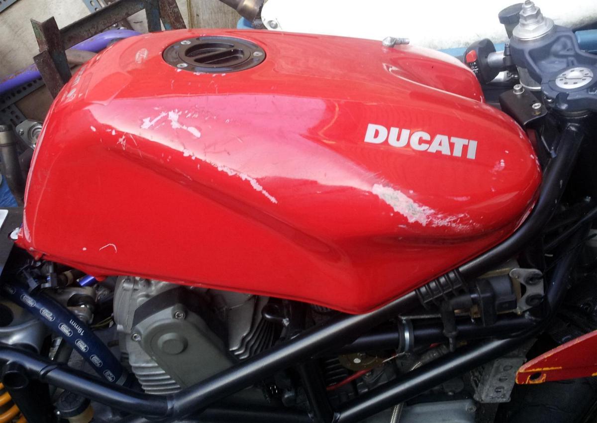

Old 22-Jul-2013, 00:08   #26
Not a lot of Progress of late
Just modified the 748 tank, fitted the pump and plumbed in the fuel connections.
Also did a bit of prep ready for the lock wiring
Hopefully tomorrow Dallas will weld on a couple more brackets for me so I can make a battery mount and then I can crack on with the electrics
Photos may be of use to Roxy
Click image for larger version Name:	DSC Tank Mod.jpg Views:	301 Size:	108.4 KB ID:	13638  Click image for larger version Name:	DSC Pump.jpg Views:	290 Size:	144.3 KB ID:	13639  Click image for larger version Name:	DSC Tank With Pump.jpg Views:	283 Size:	96.0 KB ID:	13640  Click image for larger version Name:	DSC Lock Wire.jpg Views:	297 Size:	114.2 KB ID:	13641
They are indeed of use !
I've just about got all the bits ready for the project, although I've no idea where the battery is going to go !
