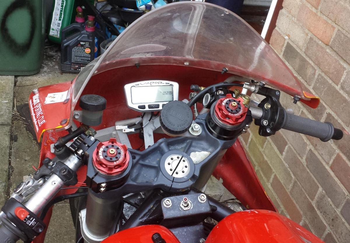

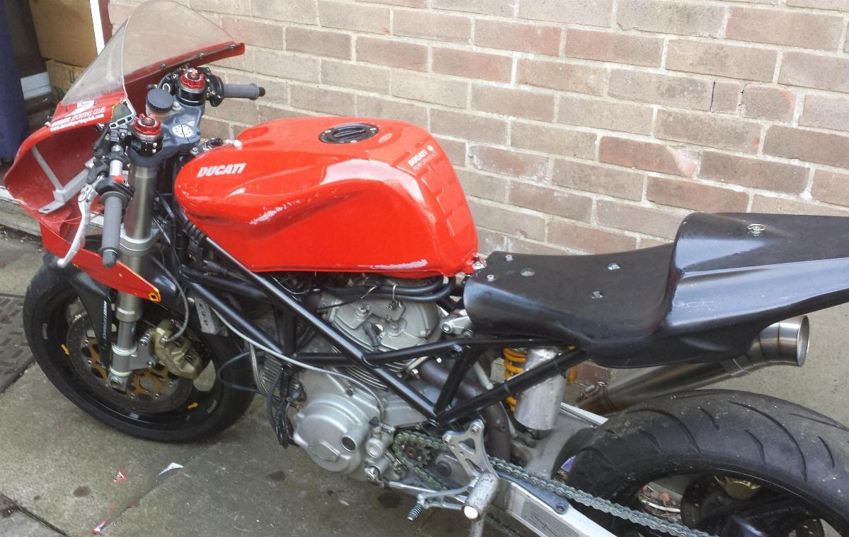

Progress at last
New Chain sliders/guides, New Chain and New Case Guard fitted
Small Allen bolt behind the front sprocket lockwired
Forks swapped from ST2 adjustable ones to 750 Supersport ones containing Mupo Cartridges
Bars now fitted above the yokes
Still quite a bit to do such as fitting a Reg/Rec, Tacho, Seat Pad, along with sorting out the gear change, bellypan, battery retainer and the fairing mount that the Brake Mastercylinder fouls on soon as you add a bit of left lock

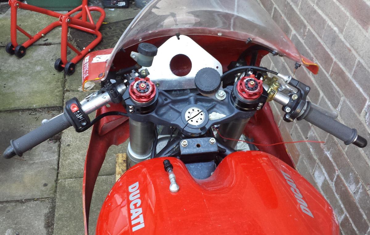

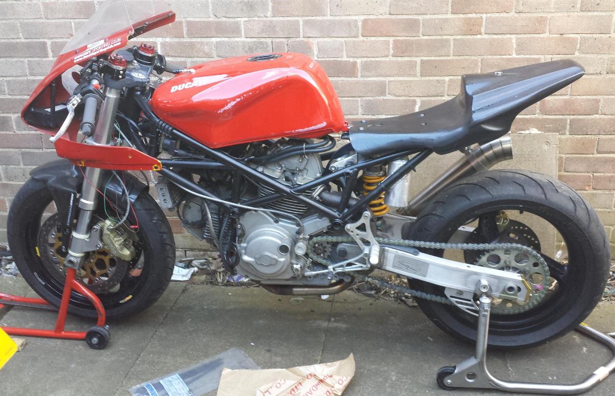

All the above now sorted, so nearly ready for its maiden outing on the Brands Test day.
Just waiting for the seat foam to arrive the only things left to do are oil and filter change, then lockwire everything up. Then make some spacers and brackets and get the Bellypan fitted.

well I can't say Brands went to plan as the new bike just didn't want to run right and by the time I had cleaned the fuel pump and changed the fuel filter to get it running properly there were only a couple of sessions left in the day to get out on it.
I used the first of those sessions to Scrub new tyres on the race bike and then went up to pit lane for the final session to try out the new bike. Only to have the final session canceled due to an incident on track where a couple of bikes came together and then deposited Antifreeze on to the track.
Still even just riding it up to the pit lane and back and a couple of times around the lower paddock I gathered some info on things that need sorting
Firstly the seat is to low, so I will be adding an extra layer of foam.
The standard allen bolts for the footrest plates catch on my boots so they will be replaced with domed headed bolts.

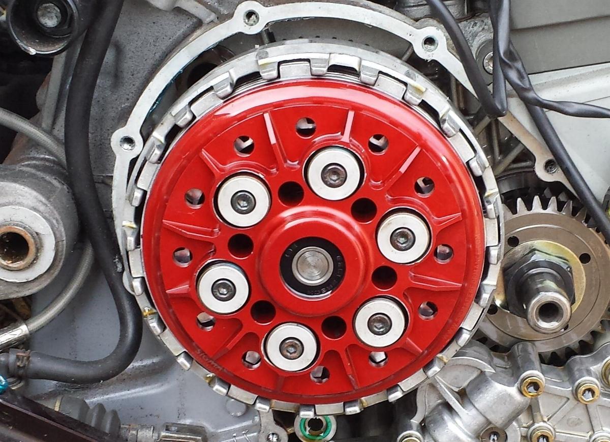

The clutch needs looking at and possibly replacing as there is a lot of drag and a nice lurch forward every time I put it in gear.
So tomorrow I will start looking at addressing these issues
Old 30-Mar-2014, 09:24   #29
Right that's the Allen bolts changed and hopefully the Clutch is now sorted
