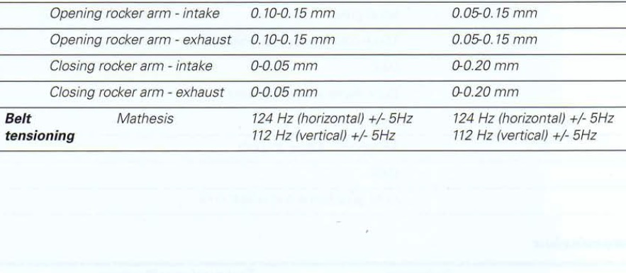

Can people let me know their valve clearance on openers and closers please and state if its in inch or mm........ thanks in advance.

From the manual
Click image for larger version Name:	valves.jpg Views:	931 Size:	73.3 KB ID:	14277

Thanks Kev,
what is the significance of the left and right column? Is it hot and cold engine?

Originally Posted by Lee M
Thanks Kev,
go with left column cold- forget the right- easiest way to adjust them is with head off then you can lap them in with grinding paste before you set them- also you can spin cam with opening rockers pushed out of way and check cam turns free without dragging on closers- california cycleworks vid "valve adjusting on ducati 2valve" on youtube makes all very clear

Old 14-May-2015, 19:21   #26
on the Left we have what Ducati recommend you set them to and on the right the tolerance

the tolerance/ service limit given always seemed so wildly out to me seems better to keep them closer than that- 0.05 and 0.2 seem a world apart??
