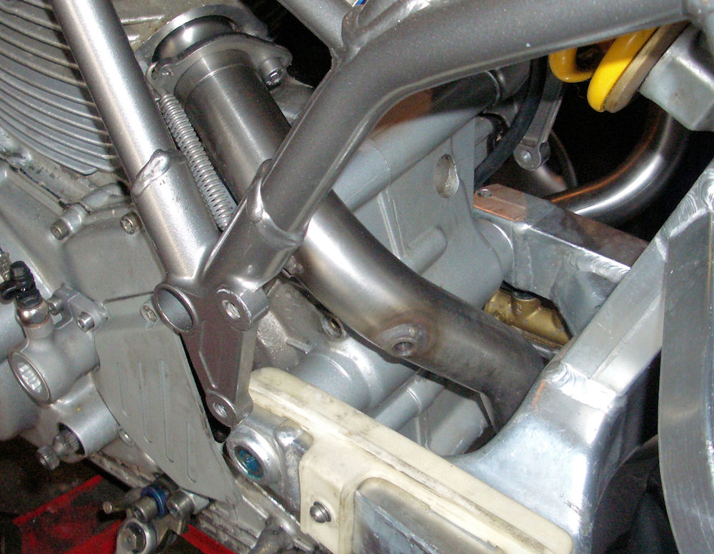

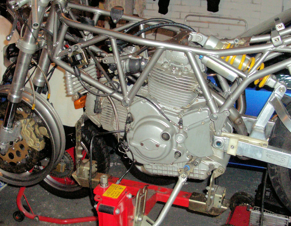

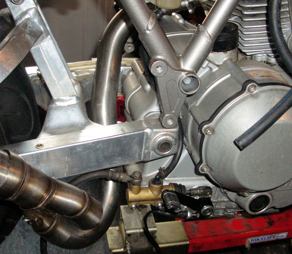

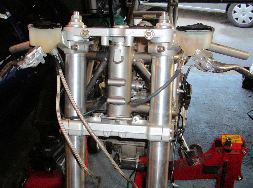

Smile DD on STEROIDS anyone.....YEAH BABY !!!
Here's my next creation ............
Mmmmmm love those Termi Headers......999 Radial Masters.....Carbon Loraine brakes..........mmmmmmmm....
What you think peeps.....(and all done on the 'Dole' as it used to be called!)
Marko
