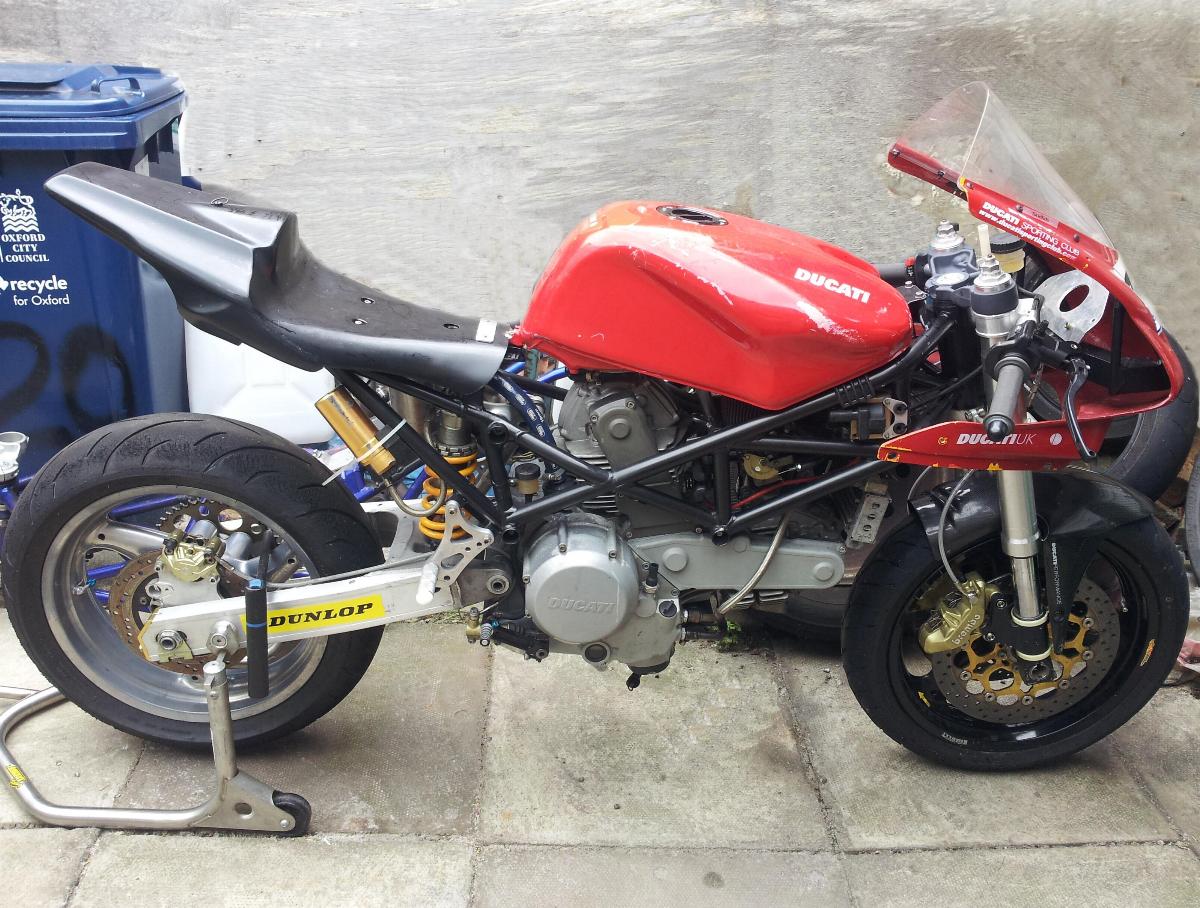

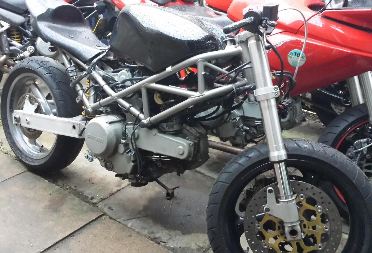

I'm going to make the most of the time over Xmas and get on with my two bikes and sort out a harness for Dallas's new DD bike, as well as rebuild a 620 engine that needed a replacement crank
Below firstly is a pic of where I was at with the #1 bike and the second pic is just about where I am with the #2 bike, although both bikes now have Exhaust headers and a 2 into 1 conversion
Hopefully by the new year they will have progressed some

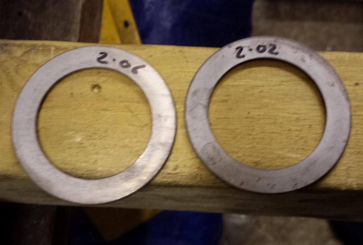

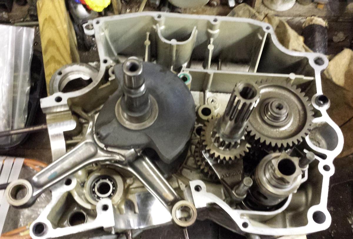

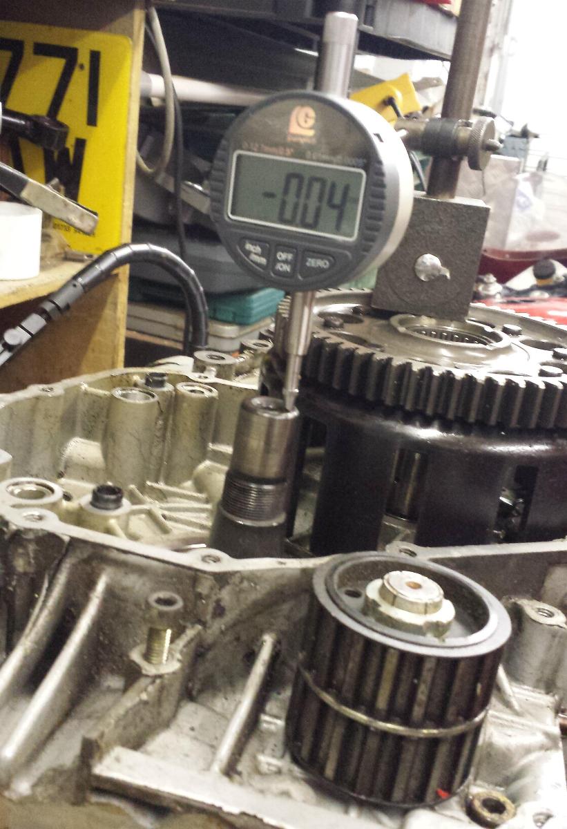

Started rebuilding the 620 engine today. Tomorrow morning will be spent shimming the gearbox and the crankshaft and then bolting both cases together before heading over to H-Cafe for lunch

Interesting Kev, what yokes are those in the No1 bike?
Old 22-Dec-2013, 09:26   #4
Monster ones just that the top yoke is upside down
And that's exactly what happened, got the cases bolted together then headed over the cafe to meet up with Andy & Karen Claridge, Kev and Trudi Palmer and we were also joined by Steve Baden who was the only one of us foolish enough to be on his bike, then again his wrist hasn't been out of plaster that long following his crash at Pembrey (1st Visit) so good to see him riding again, just a shame the it really tipped it down just as we left H-Cafe
Few pics of the engine rebuild

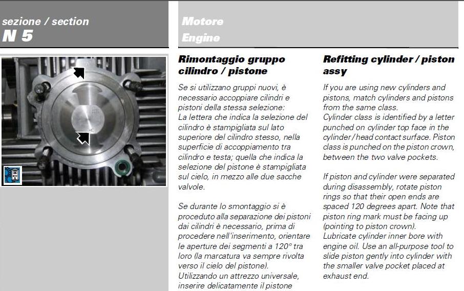

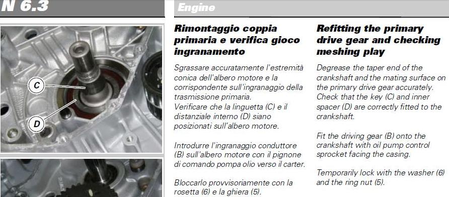

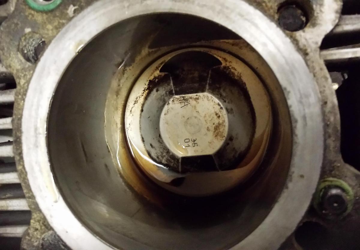

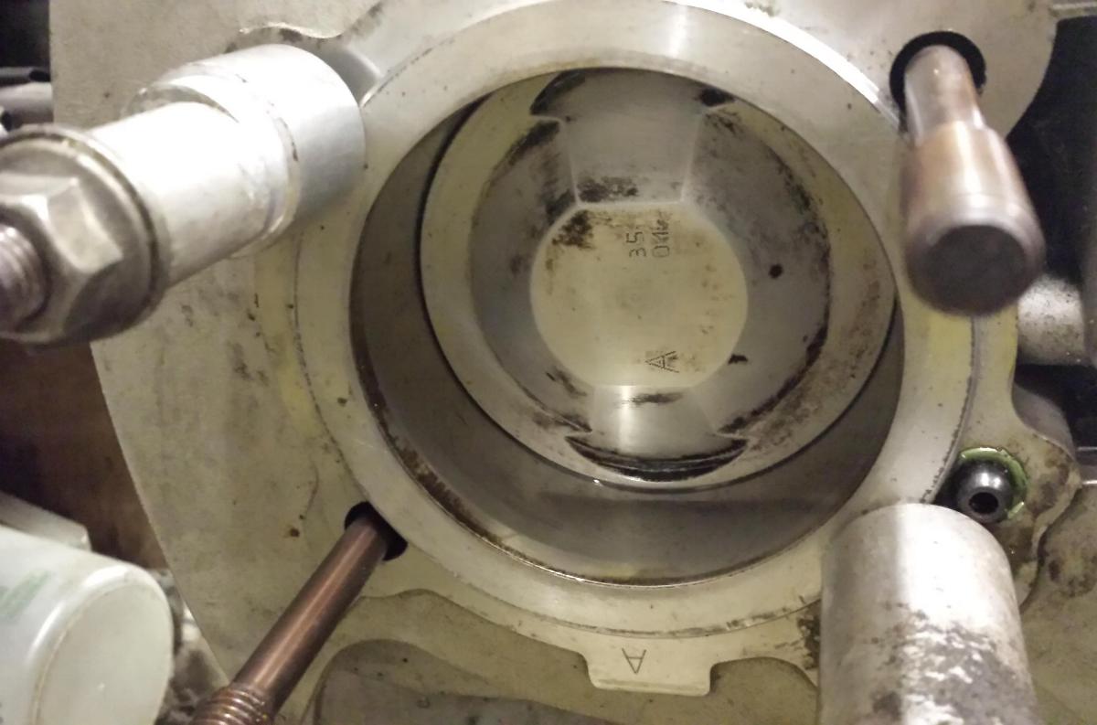

Manuals funny ha ha
Manuals Don't you just love them
Two pictures of Extracts from the 620 workshop manual
What inner spacer behind the Primary gear
Which is the smaller valve pocket in the top of the piston
why turn it upside down?
Old 05-Jan-2014, 22:55   #10
Clipon positioning, unlike the one on your supersport the Monster yoke is stepped leaving little room to place the clipons below the yoke
How you getting on with fitting the 916 tank to the SS frame, I was hoping to have seen some photos by now
