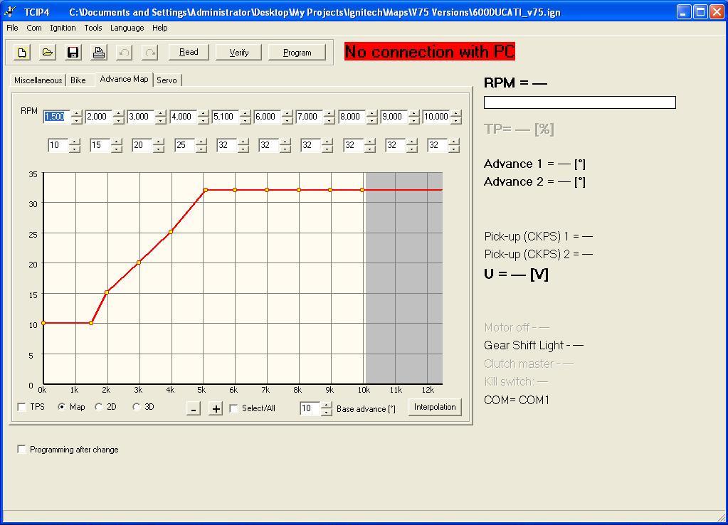

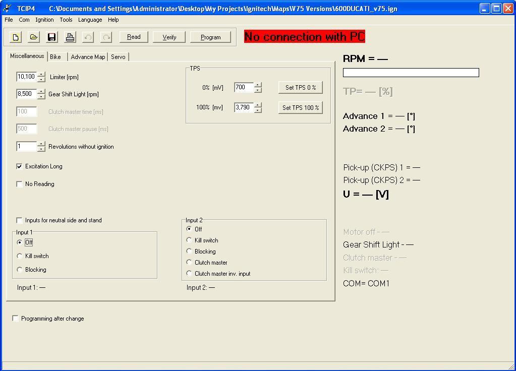

The Ignitech for a Class B bike is the TCIP4, last time I looked
You can get them for around £160 new, again last time I looked.
They come with a harness to suit the bike they are bought for so if you buy a Ducati one it will plug straight in in place of the Igniter boxes
Attached are a few Screen Shots I have taken in the past
Andy's setup for £100 is a good deal for two OEM Igniters and 2 coils
Click image for larger version Name:	Advance600.JPG Views:	1740 Size:	95.5 KB ID:	14208  Click image for larger version Name:	Bike.JPG Views:	1506 Size:	87.4 KB ID:	14209  Click image for larger version Name:	Misc.JPG Views:	1505 Size:	81.2 KB ID:	14210
