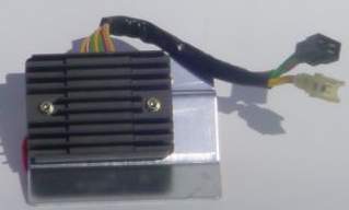

New Voltage Regulator Design
Regulators put out a lot of heat themselves and have integral cooling fins built into their casing to help reject this heat. The additional heat sink, although not finned, was however somewhat reflective and designed large enough to shield the RR from the direct heat from the front cylinder exhaust pipe.
Note that if you fit one of these to an older bike you loose the functionality of the charging light.

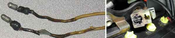

The second regulator redesign also incorporated a revised electrical connector so Ducati sold an upgrade wiring adapter kit to connect it to the bullet-type connectors of the original design. The apparent reason for this new connector style was that the original connectors would loosen and corrode so as to develop a high electrical resistance and overheat. Unfortunately the new connector style had the same problem.
Voltage Regulator Connector Overheating: Old Design/New Design
The regulator fails because there is often not enough cool air available to remove the heat generated internally by the unit and the internal electronics are damaged. At speed, outside cooling air is supplied directly to the regulator via a NACA-style duct opening in the fairing. It apparently wasn't big enough, so when the 998/748 was released, a larger duct was incorporated into the design.

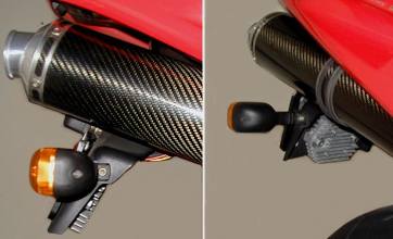

The best solution is to move the RR outside the fairing to the outside air stream for better cooling.
In my case, I replaced my fifth failed regulator with an Electrex unit, extended the larger gauge wiring (see below) and mounted it on the underside of the license plate holder facing the rear tire where it’s hardly noticeable.
Relocated Regulator for Better Cooling
Adding a regulator cooling fan was tried first, but the ambient temperature inside the fairing is just too hot to use as cooling air. Even though I wrapped the front header pipe in high-temperature insulation to reduce exhaust pipe heat transfer in the fairing to a minimum, the regulator surface temperature still climbed well beyond 160°F at traffic lights.

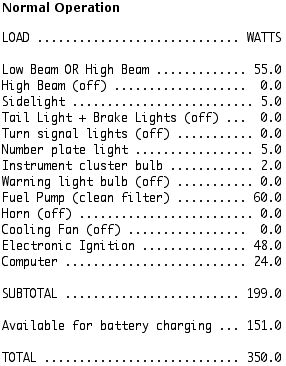

The initial charging system design had a 350 watt single phase alternator. Here's the design basis that Ducati used for sizing the system:
Design Basis
Note that the system wasn't designed to run both headlights simultaneously.
Note also that the power rating of the fuel pump assumes a clean fuel filter. Ducati fuel injection systems use a high pressure fuel pump powered by a DC motor that draws a fairly-high current and a dirty/clogged fuel filter will causes the motor to work harder and draw a much higher current. So the in-line fuel filter inside the gas tank requires regular replacement. A pump feeding fuel through a clean filter will draw about 2 amps, but this figure can rise to 10 amps with a dirty filter. Clogged fuel filters are a prime contributor to regulator failures.
Of course the electrical system doesn't normally operate with everything turned-on at the same time. So here's a more common operating condition:
It's important to note here that, given the obvious need to charge the battery, the stator wires will have to pass 29 amps (350 watts/12 volts) continuously. So I advise you to keep your bike on a trickle-charger whenever possible to reduce the demands on your charging system. Also, avoid the temptation to replace your battery with a low-weight, lower capacity unit. The principal advantage of using a larger battery is to be able to restart repeatedly. If you regularly don't ride long enough to recharge fully between restarts, stay with a larger capacity battery. A lower amp-hour battery will need to be trickle-charged more often.

Generally though, it is the connectors heating up that causing the insulation and conductors to melt and short out. Even if you haven't had a charging failure, next time you have a chance, check your wiring for damage.
On my 916, for example, the stator wires got so hot that the insulation became brittle and cracked near the regulator connectors. A closer examination showed that the damage extended along the wire all the way back to the engine casing. I could scrape off the softened insulation with my fingernail.
So even if the stator wire resistance measurement and the voltage output checks out OK, the output to the regulator is unreliable because the insulation between wires (that run in a common sheath) breaks down at the higher voltage levels at higher RPM.
The undersized stator wires generate the highest heat load at the points of highest resistance on both ends; connector to the regulator/rectifier (see above) and at the other end where they attach to the stator. Note in the picture below, the discolored heat-damaged insulation on the two yellow wires where they connect to the stator coil lugs.
Heat Damaged Insulation at Stator

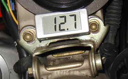

Finally, I recommend installing an inexpensive digital voltmeter to get more information about the health of your electrical system. An on-board voltmeter will flag a charging system that is behaving erratically and intermittently prior to failure. When the charging light comes on it's too late.
Digital Voltmeter Installation
The model (Lascar EMV 1200) I use is shown here installed on a superbike: The meter's current draw is so small (3 ma) it can be left on continuously without draining your battery. You can buy it in the UK for £20:
http://www.lascarelectronics.com/pro...KEN =47647414
To install, cut both lead wires to within an inch or so of the threaded stud. Solder a more substantial wire to each lead and run them directly to the battery terminals. Fit a piece of shrink tubing over the voltmeter's threaded stud and wires to prevent excessive bending or fatigue failure where they exit the meter.
As you can see, I mounted the meter directly below the water temperature gauge on my 916. You can run the shrink tubing covered wires down between the bracket and the instrument housing. The meter is so light-weight that no additional mounting bracket was required, the stiffness of the shrink tubing is enough to keep it from moving around. A small piece of foam placed between the bracket and the bottom of the meter will keep it facing you. If you mount it too rigidly it will see a lot of vibration that could shorten the life of the meter.
As a final note, use the above electrical load tables to see the effect that additional electrical loads will make when you make changes such as running both headlights together, added auxiliary equipment, or the use heated clothing.
The 1995–1998 superbike models were designed with a 350 watt alternator. The 1998 ST2 is unique, it was Ducati's one and only 450 watt single-phase system. For the 1999 model year 1999, Ducati redesigned the system going to a 520 watt 3-phase alternator. Make sure that your power demands during all expected operating modes don't exceed these levels. Adding additional electrical equipment or using a lightweight low-capacity battery, on pre-1999 bikes in particular, isn't very prudent.

Agreed Paul, however it gets no air flow as on mine the regulator was hidden behind the chin section of the upper fairing and relies on sinking heat into the headlamp surround casting using a dielectric paste ( which will break down with time & heating cycles ) and ambient air cooling.
When mine went u/s, I relocated the replacement inside the air intake at the front to get a constant air flow.

Shazaam - nice pic of the melted plastic connector, looks exactly like the one I found on my bike!!

Your connector is famous over here in California, mate. (Sorry about not crediting you. I just couldn't figure out where/when I found it.)

A great post. My connector is nuked just like the one in the photo. Going to sort it out today though. Was going to connect the wires again with another connector but may go for the 'hard' wire

I bought a new connector from Snells (better type/make that they use for this type of repair - about £4) cut back the wires where the insulation had gone soft and job done.

cut out the connector, soldered the wires together, taped them up. Tested the circuit with a meter and all back to normal.
