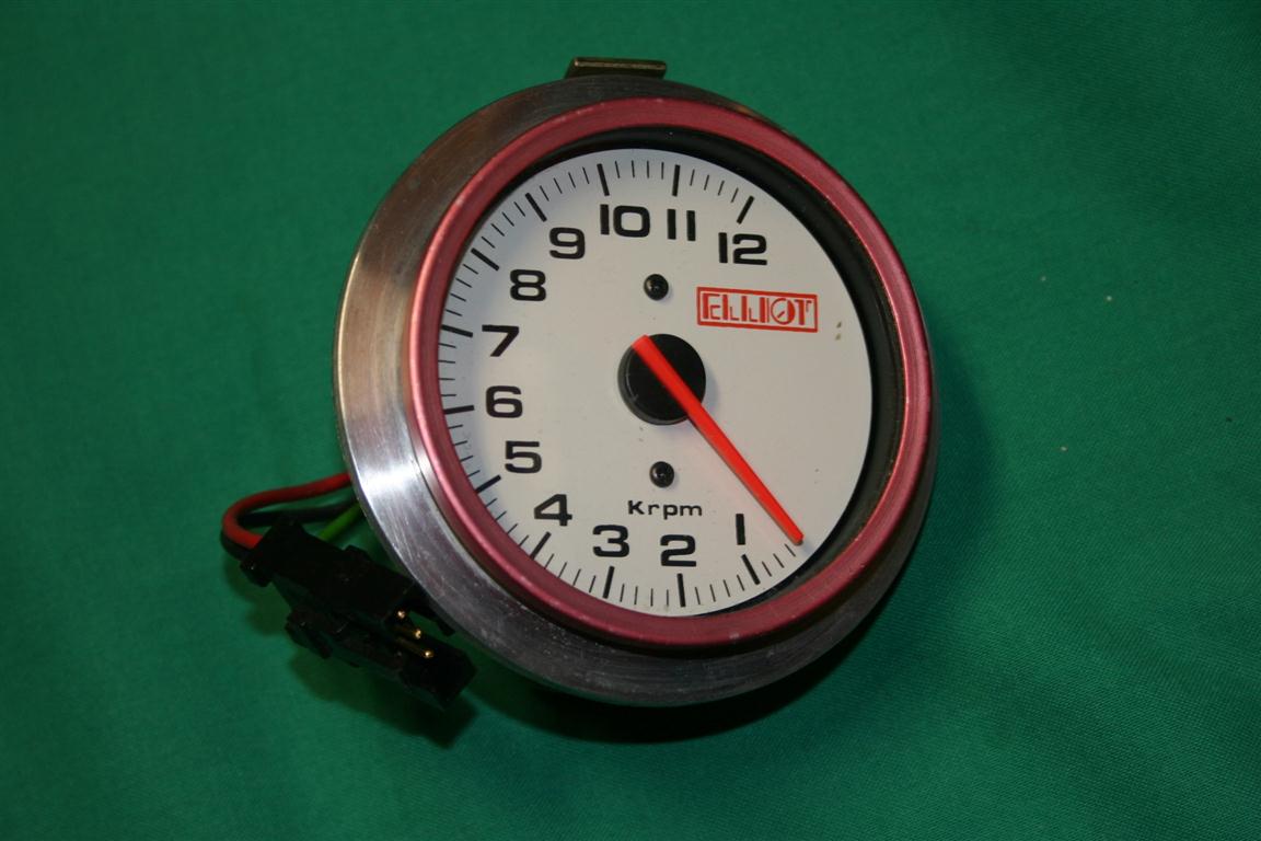

I have an Elliot Tacho for sale if you need one.
Click image for larger version Name:	Elliot Tacho (Medium).JPG Views:	171 Size:	95.5 KB ID:	11464
