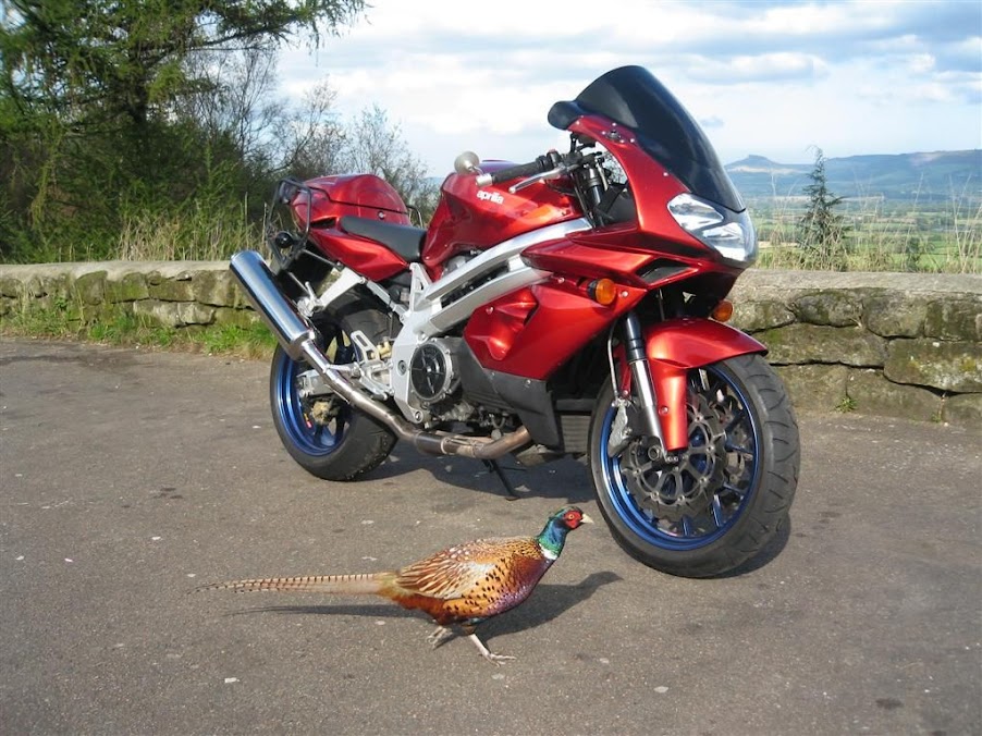

Yes, indeed - this one, perhaps
... The Falco Feasant Fryer
