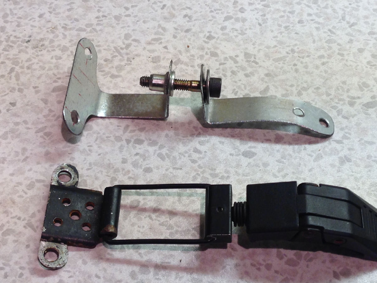

So having a quick look about I see that Kevin has said that the tank now has to be held down with something a bit stronger than the existing strap thing.
Any ideas (photo's would be good!) on how to do this on a 600 SS?

I came up with this idea for another bike, this was first draft and needed altering. The frame part needed shortening to clear top triple clamp. But you can see the idea and it works.
Click image for larger version Name:	tank secure.JPG Views:	1534 Size:	178.1 KB ID:	13815

For some reason I thought that I would have to weld something to tank and bike.
Is that steel or aluminium?

I think its some stainless that I had kicking around Dan, but aluminium would suffice too. Also if the two parts do not meet then a suitable spacer in between should be used so that there is something positive to clamp down to.

Hi Dan, if you still have the ss I made mine up by using the frame mounted retaining clip. I just strightened out the loop and welded a peice about 15mm wide by 1mm thick to the strightened out end. I drilled two holes to corrisopnd to tank and used a peice rubber (from exhaust can bracket loop) to protect the tank. You will have to grind out between the two mounting bolts to get clearence for the head bearing, but will make sense when you look. Mark

Have a look at my post in the Desmo Due Paddock group on Facebook and see what I've done, mine's a Monster but something similar may be done on an SS.
