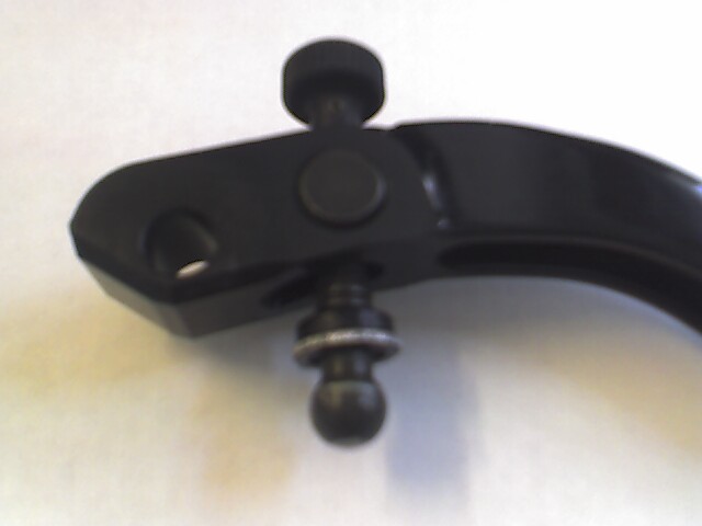

Got the m/c off last night and it has indeed pulled the ball out through the alu washer, so I'll be sending it off to GPR for repairs and will let you all know how I get on.

Originally Posted by couchcommando
What causes them to fail like this ? is it a bad design ?
As Paul says it was my fault entirely as I took the bike out of the van. It looks like the alu washer is designed to break in that way to save damage to the more expensive components - a bit like the shear bolt holding the mirrors in place on the 916 line.

Apologies for the out-of-focus piccy but it's from my Treo and it doesn't have a macro mode! You get the idea anyways, just squint your eyes a bit...
