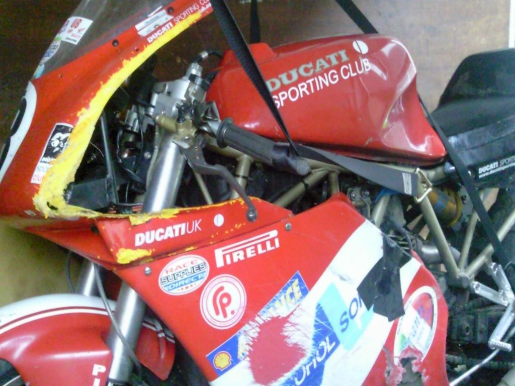

Pre 99 models have two short bolts on the front engine mounts that screw directly into the engine and as the engine case castings don't go right across the frame you shouldn't really be drilling them out to fit one long bolt all the way through.
I did make some for Senna3 a few years ago that served him well
Maybe I should have had some fitted last weekend while tyre testing
Click image for larger version Name:	Oops.jpg Views:	302 Size:	105.4 KB ID:	11357

Ouch!

We (Bionicle, Skids & myself) spent an hour sorting Skids bike out in the cold and wet we had to wheel it down behind the cafe and use there hose to clean the mud and stones that ended up inside the fairing, but we managed to sort it, the baffling thing was that the rear belt had jumped a tooth on the cam sprocket, did not sound healthy at all, but Skids sorted that and it was fine on the next start up
