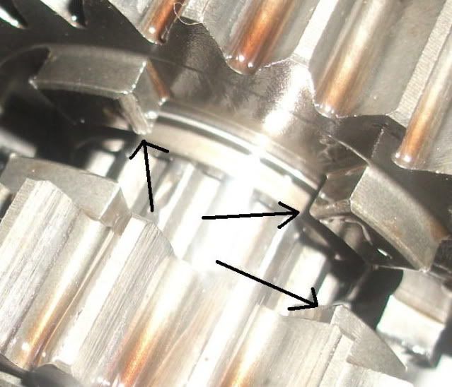

Although more than happy with my results fron Snetteton last week the bike had become increasingly difficult to change between 2/3 particularly downshifting and more so as the bike went faster/got hotter. After checking the selector was correctly adjusted I decided to bite the bullet and split the cases. This is what I found.
Although the damage to the dogs is what seems minimal to me (my first gearbox issue) would this have been enough to manifest itself as the problem?
Drum/forks/gears all perfect.

That damage is initial engagement, the flanks of the dogs have an angle ground on them to hold into mesh. I would sit for a while and stone those areas. Have you had some clutch drag?? The gear slots look the worse affected.

No drag Phil. Just a pain to get into gear. It wouldn't jump out of gear once in but if I didn't make an over positive change I would get a false neutral etc.
Considered taking off 3 dogs on each gear?
Fresh box in now just waiting for headgaskets.

The drive side of the slots have had some trauma, has it been used with a quick shift kit now or prior.
Third and fourth I wouldn't have a prob removing the dogs, as the torque is considerably lower.

If the selector fork and all the teeth on the gears are OK I'm suprised the slots are that damaged, unless there is a shimming issue.
Which box did you replace it with, 996 or a 748 with closer ratios
