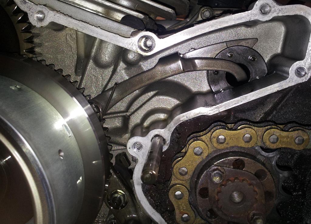

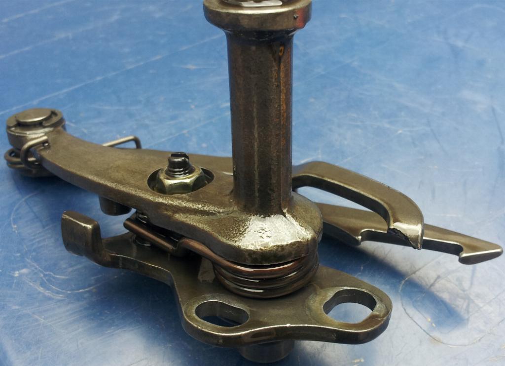

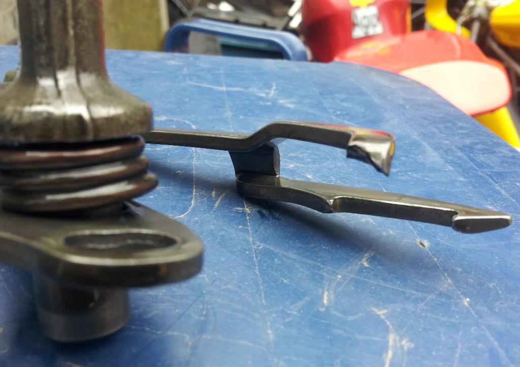

For the last couple of rounds at Anglesey and Oulton I have been surrering a few gear shift problems, namely when trying to change down from 6th to 3rd in a short distance, such as the run into the Shell Oils hairpin and no doubt it would also have been a issue into Park in a couple of weeks time.
If I did try changing down 3 gears in short succession I would let out the clutch and find I was in a false neutral between 2nd and 3rd gear, where the selector drum had over shifted. Going down another gear results in a locked rear wheel so if it happened it was a case of shifting back up a gear into 3rd
I did think about just trying to adjust it but decided to buy a replacement gear selector first.
Well today I stripped the Alternator casing and the flywheel off and removed the gear selector and this is what I found.

Great photos, any chance of a simple explaination of how it works?
Old 02-Jul-2012, 13:41   #7
Probably easier to explain at Cadwell
But in brief the claw part that sits at the top of the selector drum pulls the dogs on the drum either left or right depending on which way you are shifting, this rotates the drum moving the gear selector forks.
The limit of each shift movement is goverened by the part that sits in the centre of the drum hitting the wall of the drum and preventing futher movement.
In my case the bit that sits in the centre of the drum had one edge broken which caused the claw part to travel to far on down shifts, hence over rotating the drum and moving the selector forks to a position where they didn't engage a gear, more often than not it was in a position between 2nd and 3rd gear
