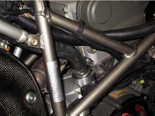

Gary Milcheck Photo
The design result of such laws is a positive crankcase ventilation (PCV) that uses the lower-than-atmospheric pressure that normally exists in the engine intake tract to extract the crankcase gases. These are then are burned along with the normal mixture of air and fuel. This system has a one-way valve that allows outward flow only, and a oil separator that acts like a maze for any entrained oil droplets that try to leave the crankcase. This (normally) small amount of oil then drains back into the crankcase instead of entering the engine intake.
On Ducati street bikes the one-way reed valve is located at the engine case opening. During certain conditions of high engine rpm and light load, more oil is entrained so the reed valves’ small drain holes have difficulty returning the additional oil to the sump quick enough. The oil separator can fill with oil and get sucked into the intake tract. Higher compression engines or worn piston rings have more blow-by, so the likelihood of oil being puked into the airbox is greater.
Because of this, and to gain about a two horsepower increase, race bikes that live at high-rpm use a somewhat different arrangement than the street bikes. A much larger oil separator box is used to effectively increase crankcase volume that reduces pressures and pumping losses.
To allow the oil to drain back more quickly, the reed valve with its small drain holes is removed from the crankcase location.

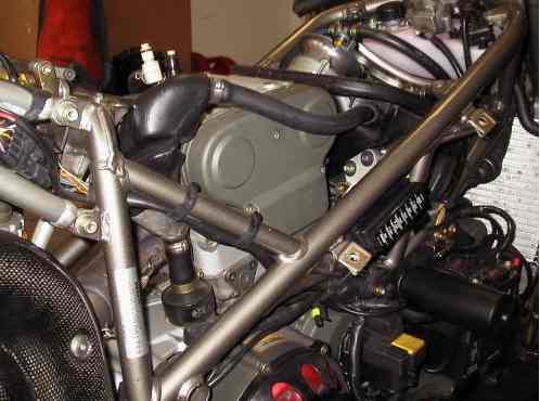

Gary Milcheck Photo
The corsa box is connected to the crankcase with a large diameter hose and located a greater distance away from the crankcase opening, under the tail. The one-way reed valve is now located at the airbox connection of the 3/4-inch vacuum line running to the oil separator. This design reduces the chances of contaminating your intake charge with oil. It also provides a large enclosed system that safely contains the oil if an engine blows.
Except for the larger oil separator volume, the advantages of the corsa system can be implemented in the stock system by hollowing-out the reed valve to remove the constriction on drainage. Alternatively, STM valveless breather connector can be used. Then use a one-way reed valve at the airbox connection. A 748RS remote breather valve works well here.

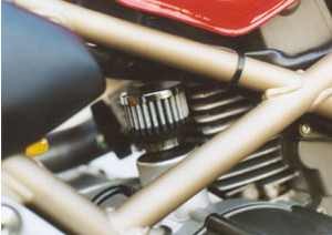

K&N Breather Conversions
The K&N breather is sold on the premise that venting to the infinite volume of the atmosphere - instead of the vacuum in the airbox - increases horsepower. It eliminates the one-way valve so it needs an air filter to prevent dirt from entering the crankcase under a negative crankcase pressure differential (pulse) when a piston is on an upstroke. Under positive crankcase pressures, the K&N device simply vents oil droplets direct to the filter medium - and beyond when it becomes saturated.
People usually buy them because they look trick mounted on the engine case. Therein lies its main disadvantage. Its location on the engine case is directly upstream of the rear tire. Since its installation also eliminates the oil separator, the increased chance of an oil mist being released onto the rear tire makes this location an unwise choice. Avoid overfilling the oil sump and wheelies with this arrangement.
Consequently, some owners have plumbed to the K&N element located in the tail where, at least, any effluent is away from the rear tire.
