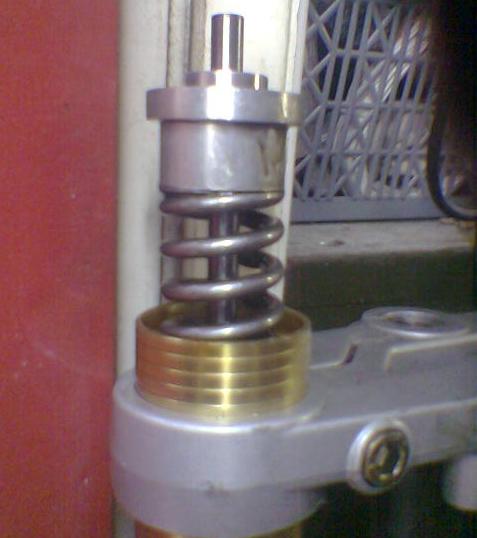

And for anybody else wanting to do something about the springs in their Class B bikes front forks
Sping is a Ohlins single rate spring as supplied for a Honda VTR1000 Firestorm
Spacer is 18mm long with a OD of 35mm and a ID of 27mm (4mm wall thickness)
Click image for larger version Name:	Class B fork.jpg Views:	354 Size:	27.2 KB ID:	1041

Kev, did you get rid of the black plastic spacer? Shouldn't it at the top of the springs?
Old 29-Aug-2006, 23:35   #4
Yep did away with the black plastic spacer, as the Ohlins springs are longer and therefore a 18mm spacer as per the pic adds the right amount of preload
