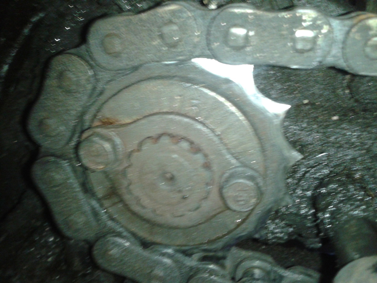

handy tip on when to change your sprockets-
when they look like this (unless you want a budget slipper clutch)

Not helped by running a 13T sprocket, the tighter the radius the greater the wear and less teeth to spread the load
