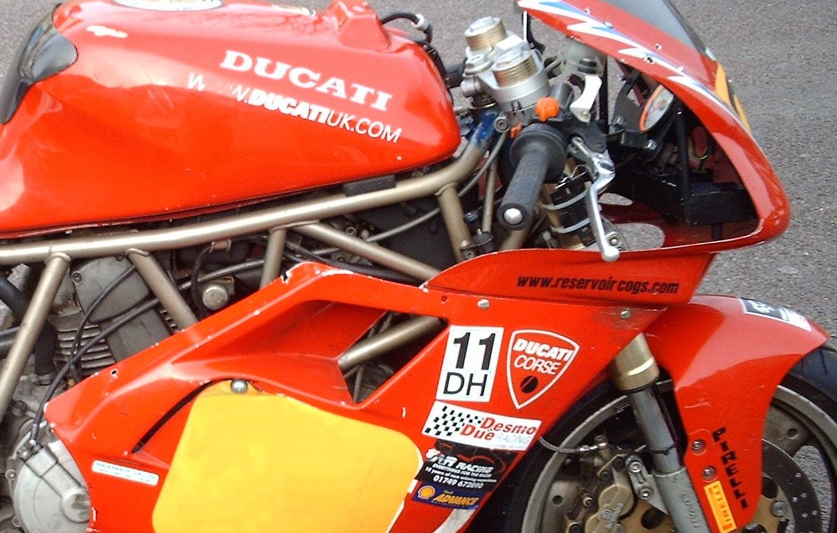

My 600SS frame developed a crack in the top frame rail just along from the headstock. I drilled a small hole at each end of the crack and then had it welded

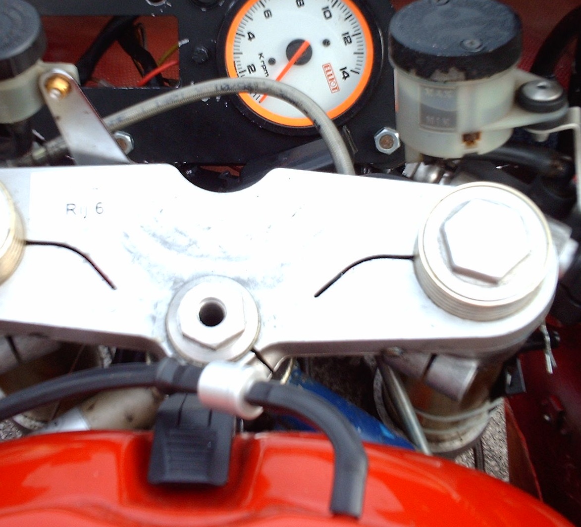

Old 13-May-2015, 00:25   #7
You can't quite see the weld, just the blue paint that I added to protect it from the rain
Click image for larger version Name:	#Crack101.jpg Views:	1205 Size:	288.1 KB ID:	14278  Click image for larger version Name:	#Crack111.jpg Views:	1188 Size:	318.1 KB ID:	14279

That looks like top of top tube. I thought it went on the inside of the top tube where the gusset weld is.
