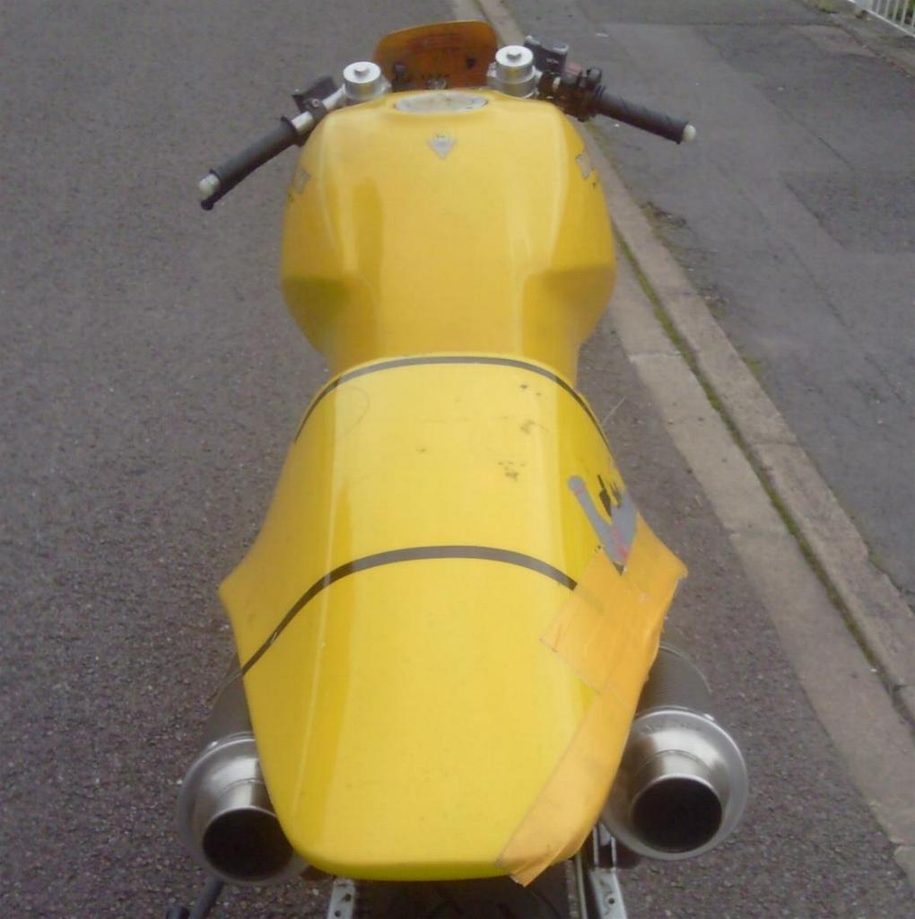

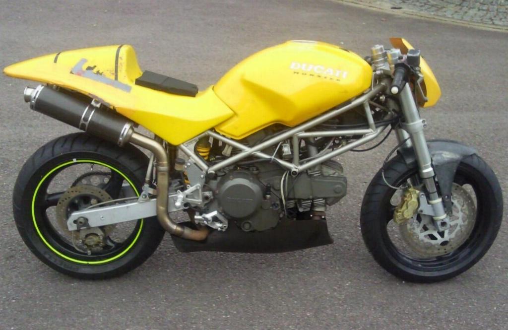

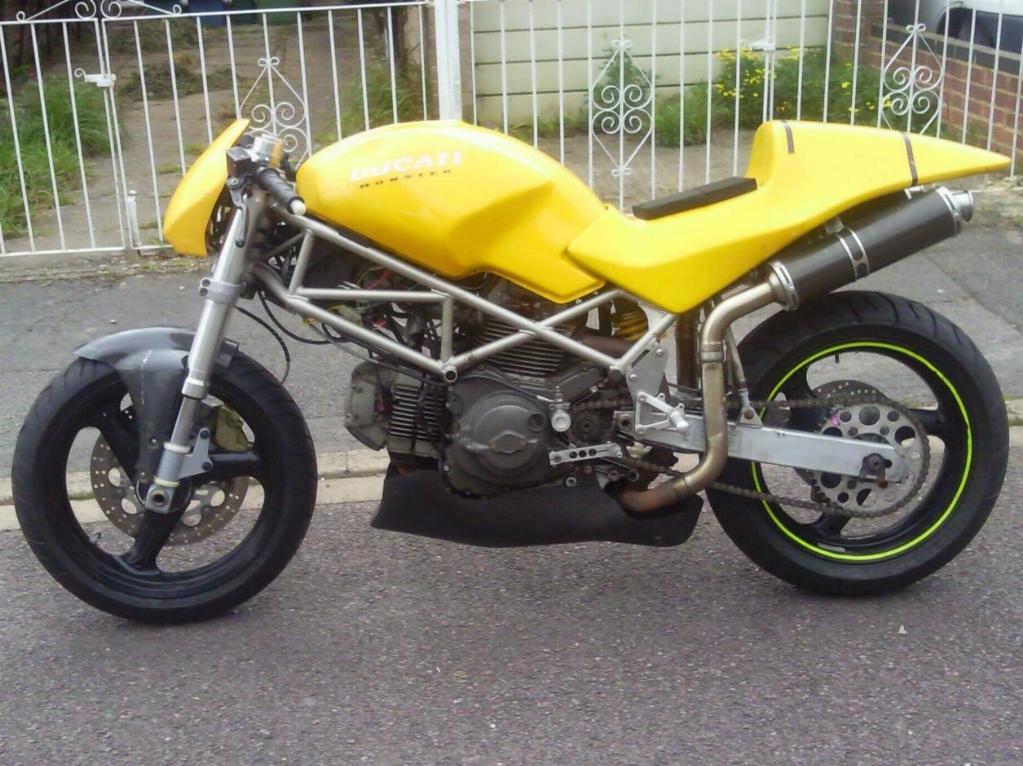

The class b bike looks good skids, very swoopy and curvy with that nose piece.
your torque does seem a bit optimistic.
Lets hope it was a training day for the operator and they get there act together before we get our (read mine) top 3 bikes on it at brands

what I cant understand is why every other monster, even with the same seat unit, looks higher at the rear than mine?!
would be interested Kev in anything you do to mod the pegs to go back further, as discused yesterday I'd like to try them further back
Paul I think you will find my pegs are futher back than yours, if I fit a reverse pattern lever the gear change toe peg ends up in the same place as the 916 one currently on it.
I could get more adjustment by fitting set of adjustable 916 pegs, the sort where the footrest is on a cam and the plates have a couple of different mounting holes.
Tim I know what you mean about the Dremel after seeing the seat that came with Dallas's bike that he bought off Jimbers
