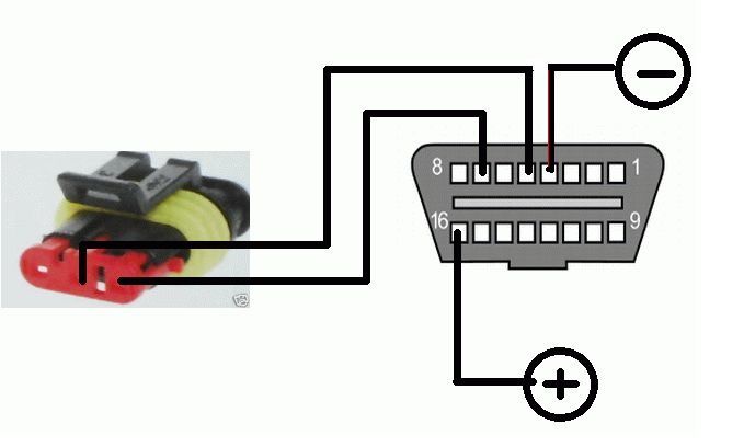

For your info the centre pin of the 3 way superseal connector is -ve ground and the outer pin is the KKL (the third pin is not connected to anything).

Thats the eady bit Chris, even for the later bikes just pull it off the Bike wiring diagrams, its a bit harder when you get to the other end with 26 pins to choose from.
I'll probably end up taking it apart and seeing which pins are used, working out the Earth (Ov) pin shouldn't be to hard.
And if all else fails I'll try buying a lead for a Tecnomotor Socio 700, but that would cost about 6 times what I can make a lead up for

On the EOBD 16 pin connectors these are the only pins used
Pin4 - -ve grnd power supply
Pin5 - -ve grnd on 3 way superseal connector
Pin7 - KKL on 3 way superseal connector
Pin16 - +12v power supply
Don't know if that will help when you have 26 pins!
