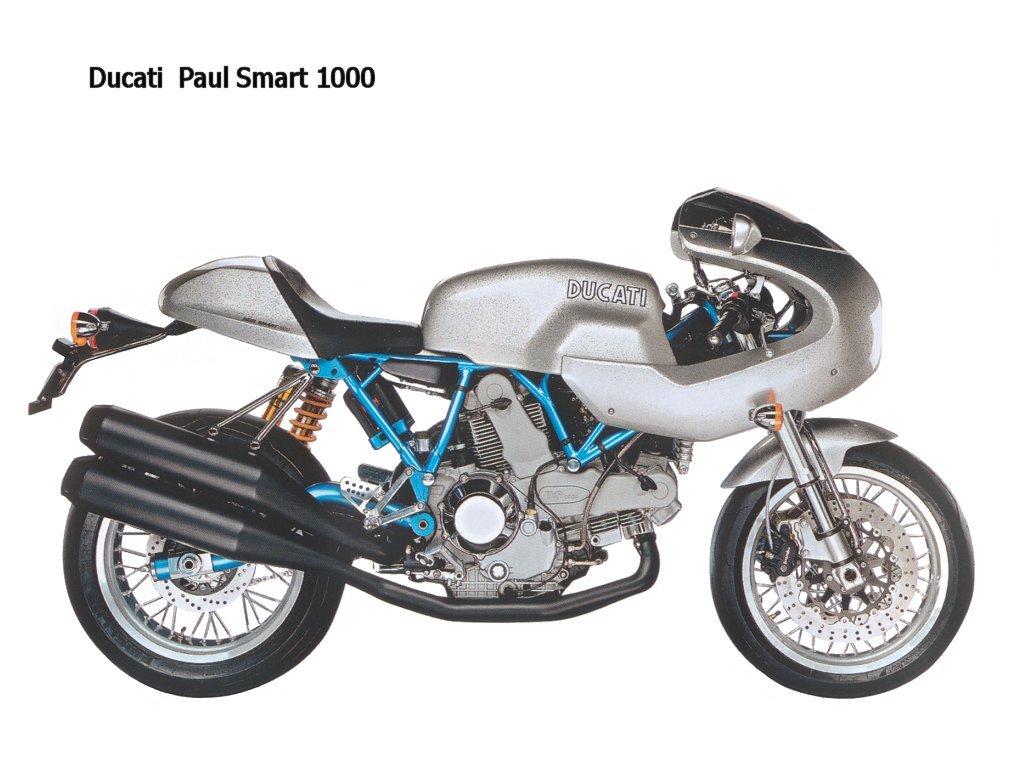

I nearly went this route too for a project, as I was offered a set of Paul Smart rep wire wheels but... different axle sizes to an older SS - but could be worked around by someone determined!

I'd try and find an alternative otherwise you will be sorting out either wheel spindles or bearings as well as calipers, or Change the forks to the later type but then you would also need a new spindle and to sort calipers
I'm sure there are wheels out there that may be a easier conversion

Apparently, the wire spokes will catch on a standard mount caliper!

Yep and as the 92 SS has 40mm caliper mounts you wouldn't be able to fit the ones from the sport classic, front wheel spindle is also a different size and fits into the forks differently.
Be better going with something like a Moto Guzzi front wheel or similar
http://image.motorcyclecruiser.com/f...wheel_view.jpg
The wider back wheel is also designed for a 180 section tyre which would slow the 750s turning down
