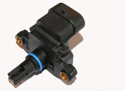

Skids, Whats this then ?
Whats this Kev ?
On a mount under the front head lamp unit 996.

Whats this Kev ?
It is the air temperature sender.

As Chris says its the Air Temp sensor
Its a Magneti Marelli ATS 05 part required by the ECU to help get the fueling correct on Cold and Warm days by triming the main fueling map

Best I leave that on then
Thx Guys.

Unless it was a 620 Multistrada it would have looked a bit different to the one in Craigs Pic

The 620 Sport and Monster combine the Air temp sensor with the Air pressure sensor
Yes, that is the little fella!
