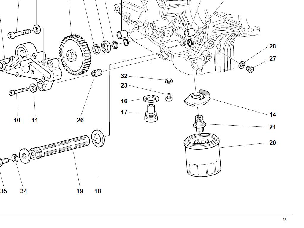

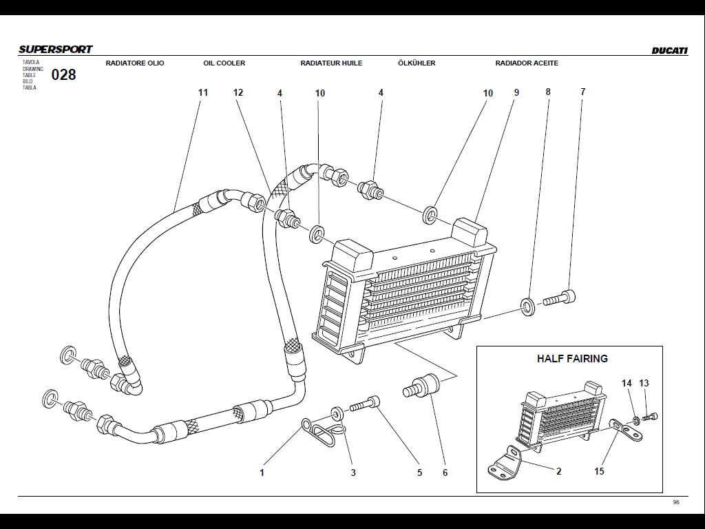

After seeing you front runners with your gucci oil coolers I had to have one. So now I have my shiny new second hand oil cooler. But how do I fix the bypass spring and what's the best location for the cooler. I've got two mounts on my from cylinder valve cover but the cooler would be in contact with the engine and suffer vibration, surly that's not cool.
Old 23-Mar-2012, 18:30   #2
Thats why they use Antivibration mounts to attach it to the Valve cover, part 6 in the attache pic, two required
6/ 700.1.011.1A Vibration damper
Click image for larger version Name:	Oil Cooler.JPG Views:	478 Size:	84.2 KB ID:	13002
Old 23-Mar-2012, 19:07   #3
Or I use two rubberised 'P' clips from the horizontal frame tube just below the reg/rec. But my cooler is from a VW.
Bypass spring goes under the filter hexagon stud, there is a raised cast portion on the crankcase for the spring to react against when tightening the filter stud.
Depending on the spring you may need to trim it to locate against its arrester.
Old 23-Mar-2012, 19:32   #4
Reminds me, I need to get one for my 620 Monster
Click image for larger version Name:	Oil Bypass.JPG Views:	512 Size:	97.3 KB ID:	13003
