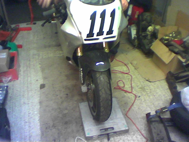

Basically, yes.
If you think about it, you can't have the same weight on two scales at the same time ... it doesn't magically appear from nowhere and disappear once you take the bike off. It's the same principle that two guys lifting a heavy box makes it easier than one guy on his own!
Mark borrowed a set of car scales from work once and we measured mine on it to see what the weight bias was like with a plan to adjusting the suspension to see how it changed the bias.
I'll see if I can dig the pic out...

Here we go...

Corner weight scales........hmmm you can have hours of endless fun messing up suspension settings with them. Usually done with the driver etc on board
Not seen much overt measurement of similar techniques (with the obvious differences due to one pair of wheels less!!) in bike racing?
Maybe front rear weight bias tuning with the rider on board is done behind closed garage doors?

MOT stations do it slightly different as in they only use one set of scales, these are usually set into the floor so that they are the same height as the floor. Then they wheel the front wheel on take a reading then the rear wheel and take a second reading and them add them together.
When using a single set of scales it is important to have them level with the surface the other wheel is sat on other wise you could be adding a bias to the process, if the scales are set lower then the bike will read over its true weight and if they are set higher it will come in lighter than it really is.
A set of scale under each wheel eliminates this chance of error.
Using two scales dead flat will also give you the weight bias of the bike and if you raise one set a known height above the other the figures can be used to calculate the bikes centre of gravity (CoG)

Only in the X direction the Z direction is quite complex.
