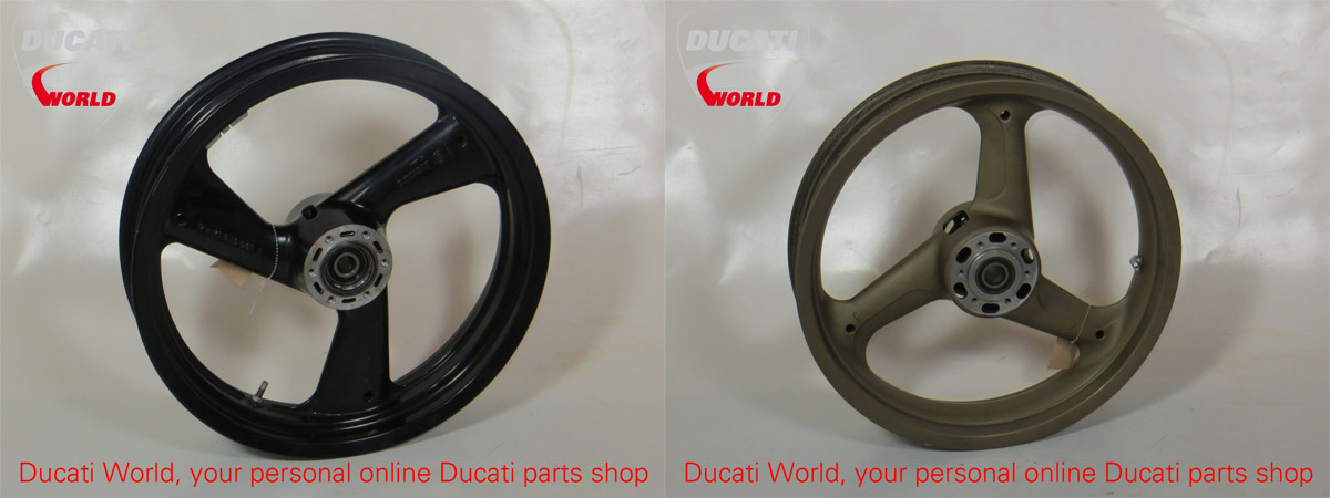

Old 11-Dec-2014, 19:15   #4
Posts: 13,101
Left = early, heavy
Right = later, light
Click image for larger version Name:	wheels.jpg Views:	1428 Size:	99.3 KB ID:	14139

The lighter wheels are not necessarily better, depends on how you ride.
The heavy wheels give you a tad more inertia which can be useful, ie up the hill to the hairpin at Brands or the first left at Cadwell. OK they may take a little bit more braking as a result but this lends itself to smoother flowing riders as opposed to point and squirt methods.
Running twin discs has the same effect.
I swapped from heavy to light wheels and to be honest couldn't tell any difference (*maybe because I'm such a smooth corner demon ) so don't fret if you don't find a set.
*or just not good enough to tell them apart.

i know from the bigger bikes a lighter wheel does make the bike turn in easier so will keep an eye out for a cheap set , they seem common enough on ebay
shame the 5 spokes aren't allowed, got one few kicking around from the monster and 998
guess the SBK ones are a bit lighter but i doubt the s2r/s4r ones are any lighter than the later 3 spokes
the bike has twin twin discs already but I'm debating running with a single disk and caliper.although I'm not small and do like a powerful responsive brake so might need some pre season testing
