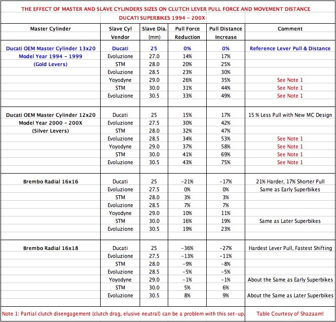

I recommend that you use nothing bigger in diameter than 29mm on a 748 with stock levers.
http://www.ducatisportingclub.com/im...es&Masters.jpg
Thanks for the info.
